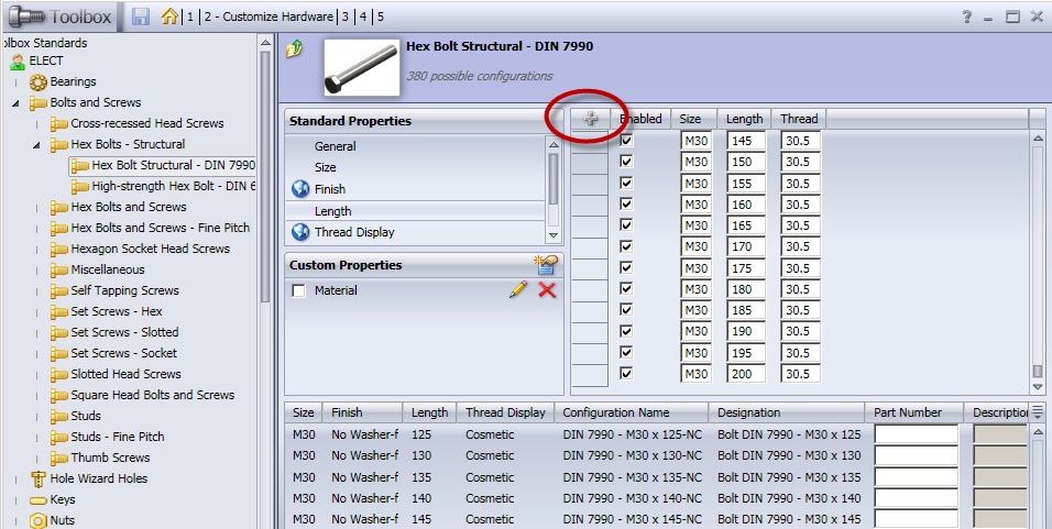

Another method is to add a new standard as a copy of the standard that you want to use. Select the screw you want to add a length and use the "+" sign as in attached image.

For those with a newer version of SolidWorks still struggling you can now do it within the Toolbox Settings
comment imagecomment image
