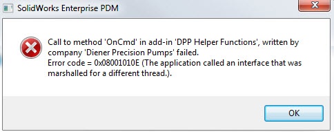

This all works fine the first time you open a EPDM explorer window. But if I close the first explorer window and open another Explrer window or open a second explorer windor then the  I get a Solidworks Enterprise PDM error message box with the text:
Call to method 'OnCmd' in add-in 'xxxx', writen by company 'yyyy' failed. Error code = 0x08001010E (The application called an initerface that was marshalled for a different thread).
So it seems like there is an issue if the add-in is called a second time by a different inistance of the EPDM explorer interface.
