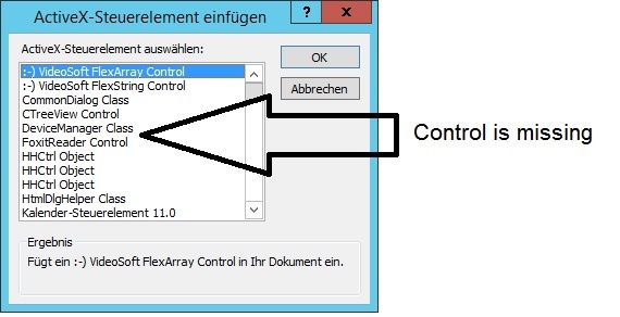

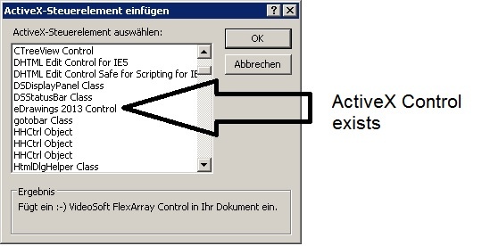

Unfortunately that fails. After days of trials and searching the internet
my result is:
Up to eDrawings 2014 32 Bit everything runs well.
No matter, whether using eDrawings 2014, 2015 or 2016 in 64 Bit:
I never get offered the necessary ActiveX-Control.
In the attachment there are screenshots to make clear what I'm
talking about. As you can see, with 2013 32 Bit there ist the
ActiveX-Control in the list off offered controls. That works up to
eDrawings 2014 32 Bit. It works on all available Windows Plattforms.
But if eDrawings 2016 64Bit is installed, thit control is missing.

Just got these answer from my local SolidWorks-Support:
There ist no way to get the eDrawings activeX control in 64Bit running in any 32Bit application.
For me that are absolutely horrible news. And I cannot understand, why SolidWorks is doing that
to their customers.
Because it is not possible to run a 32 Bit-Office side by side with a 64 Bit-Office, the consequence
is, that we have to switch on every machine in the company from 32 Bit - Office to 64 Bit-Office.
And that means, that we have to make many, many signifcant Changes to several Applications.
Not only to these, which are using the eDrawings-Control. To ALL running applications, because
of the necessarily needed generally switch to 64 Bit Office. And that is the biggest problem of all.
Currently I have no idea how I could manage this issue. Because there is also no way to do that
step by step during a long period of time. All or nothing at the same point in time. Nothing in
between is possible.
