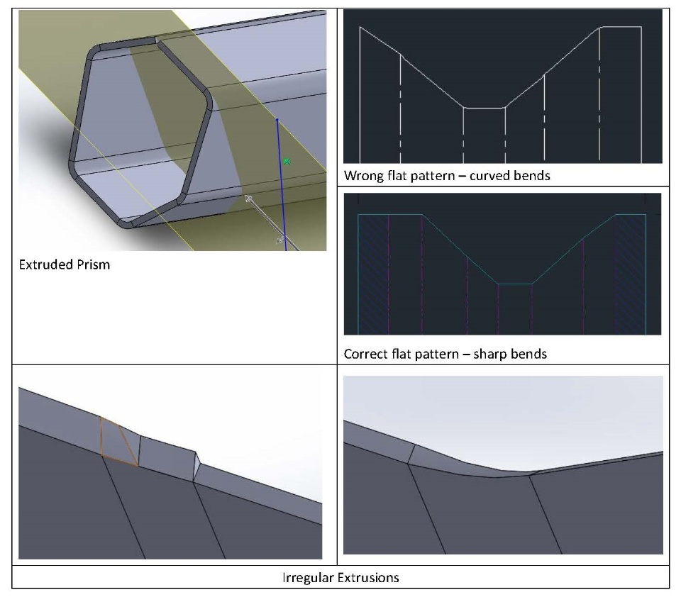

I'm designing a flat pattern for a folded prism cut at an angle of 45 on both ends. The metal sheet will be V-cut at the bends before being brake pressed.
The flat pattern I'm required to make should have sharp corners at the bends, so when the sheet is V-cut and bent, it will give a sharp finish. However, when I try to shape the prism (with K-factor of 0.4), I always get rounded corners. Moreover, there are some irregular extrusions on the borders which are impractical for production.
What I'm doing seems quite straight forward. I wonder what's the best way to accomplish this. I'm very new to Solidworks (2 days only) and it'd be helpful if you could give a bit more detail. Thank you!

From you description and images, I'm not sure what you are trying to achieve. However, every Unfold feature needs a Fold feature to be complete.
KL
KL 2013-10-31
If you know the correct shape of the flat pattern, then create it first, and use the Sketch Bend tool to create the bends.
FYI, the flat pattern you show as being correct will not produce the end result you posted. The "correct" image shows too many bends.

Scott,
See if this is what you are looking for.  I checked Normal Cut for your cut features, and to clean up the bends I added the delete face feature in the flat pattern.  Suppress the delete face and you will get a little smoother edge on the "real" part, but in my experience there is enough distortion on the inside of the bend that it negates having the extra little edges on the flat pattern.
Also you don't need the unfolds, just click the Flatten button to see the flat pattern.

Erik has sovled my problem, although I didn't need the 'Delete Face' feature as the 'real' edges are intended. To be fair, I did try the 'Normal Cut' feature at one time, but because I had my metal sheet folded, the flat pattern was still incorrect. Now I realize that the flat patterns of a folded and unfolded metal sheet are completely different. Thanks for the tip!

Thank you, Kelvin. I believe the picture of the 'correct flat pattern' included two margins on the sides for holding down the metal sheet during laser-cutting, so it should still turn out to be correct.
