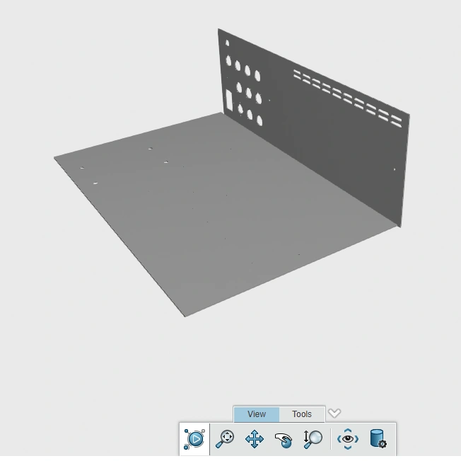

Display state shown in 3DPlay

A little update on this after some more investigation together with our reseller:  @MT
Apparently Whatever active display state a part is saved in in Solidworks Designer it will automatically be pushed to all views, thumbnails, 3DPlay view and 3DNavigate view on the 3DX platform. This will also affect whatever assembly this part is in.

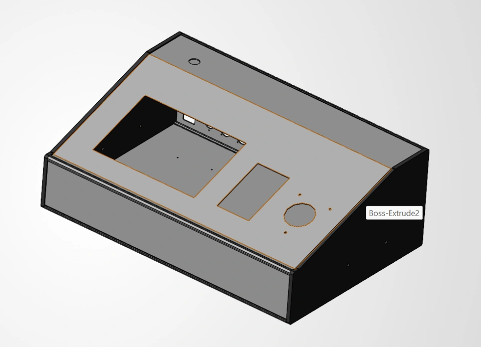

Take this multibody part:
it is saved in a green colour display state with the square box hidden.
As You can see in picture 3 on the platform the part is green and the square box is hidden including in the assembly.
This is not a suitable behaviour because this has wide ranging complications for all assemblies where a part might be used and can only be changed by a user with access to Solidworks Designer.
This needs to be adressed. The current workaround we know of is to be very diligent in what display state You save something in.
