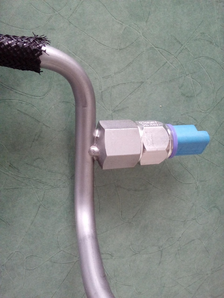

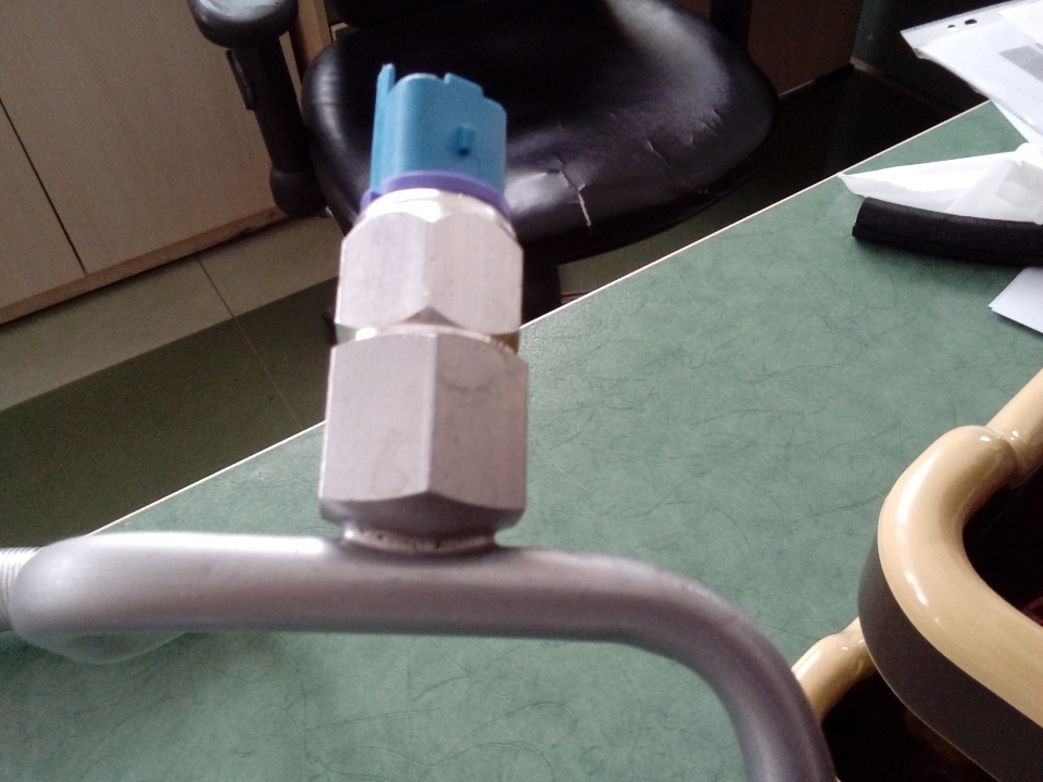

As you can see in the attached picture i want to weld a hex nut on the tube (they must be dyke completely )
I dont know how they weld together.

Is it copper tube,
is that a sensor that goes into tube,
does it need to be sealed. Because in your pictures dosent look like it seals anything.
Fusion Braze Welding with oxy
Hi ned
Material :
Hex nut : Free cutting 9SMnPb28k, tube Tu37b
It is a pressure switch Assemble that must be welded on the steel tube (Power steering 206 hose Assy. ) .
It is a mass production project (may be 80000 part /year ) .
1- Is it a manual or machinery procedure
2- what is the weld procedure ?
Tanks
Adel
1- Is it a manual or machinery procedure - this would depend on who or what company your desiging it for
2- what is the weld procedure ? most commonly it would be mig welded, though looking at the pics one side looks tig welding and the other a mig spot weld
I think it is a resistance welding
