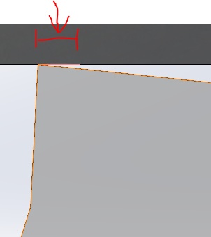

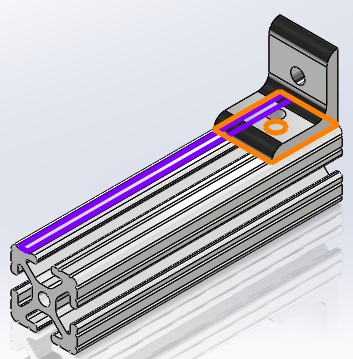

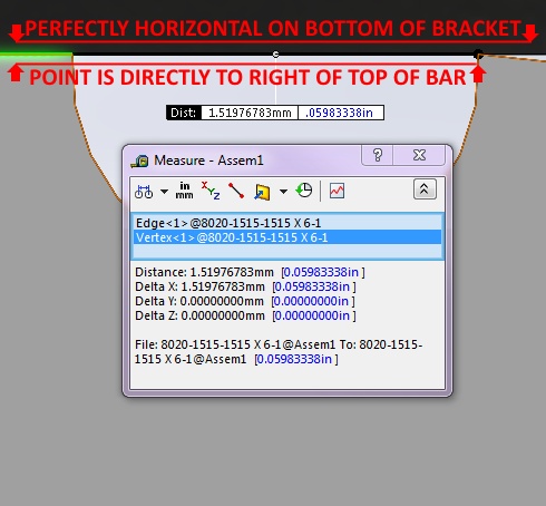

In my assembly with 8020 extrusion and brackets, the "Interference Detection" feature is finding interference where there is none, and in my large assemblies it's making it difficult to search through and find the actual interferences. In this example assembly, I have a bracket and a bar with a coincident mate between the bottom of the bracket and the top face of the bar. With the measuring tool with precision set to 8 decimal places, it's clear that the angle bracket and bar are perfectly flat and cannot intersect, but the Interference Detection tool tells me that there is 0.00017mm^3 of interference as shown.

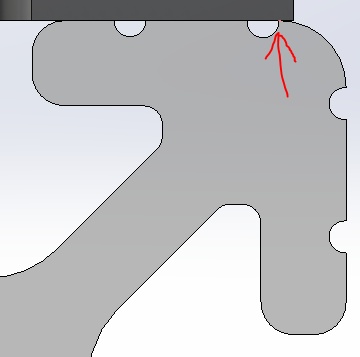

Hi Micah ,
I would double check your Extrusion sketch as it is mostly under defined, after I changed the corner Radii to tangent with the outside horizontal lines the interference was no more.
I would suggest fully defining your sketches so things like this do not drive you mad
