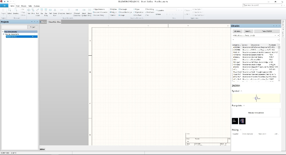

Just to chime in, SWPCB 2018 SP1 and the new internet licensing system don't work properly on a 4k display.

DL
DL 2018-02-22
Kevin,
For PCB, it's pretty much the entire application including the splash screen that doesn't scale properly. The exception is error messages and the vault sign in dialog box, they all scale normally. I've attached a screen shot from my Thinkpad P51 with the built in 4k LCD.
And yes, I was referring to the internet licensing sign in page. Since it's a web browser page I would have expected it to scale properly since IE and Chrome work fine.
