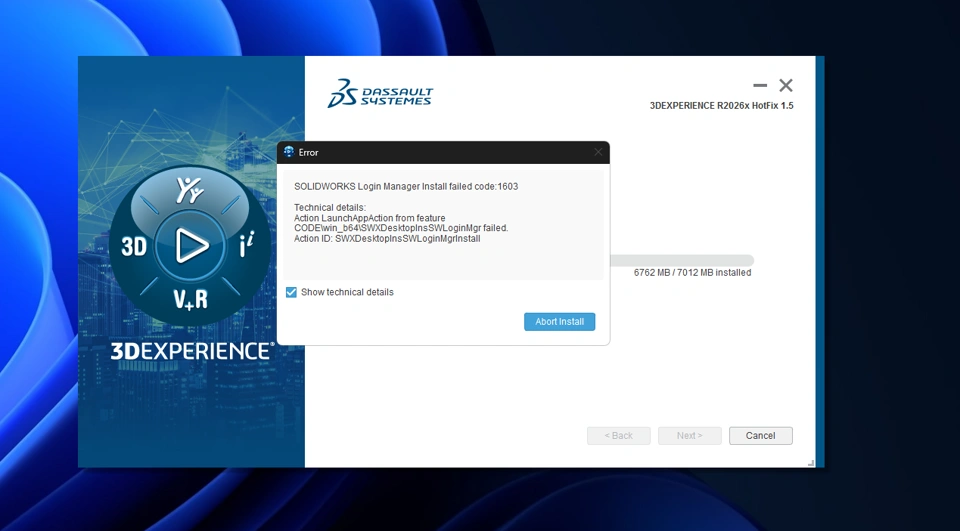

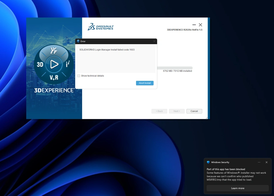

Sometimes a component can fail to update, the solution is often to uninstall the component that is failing to update, in this case SOLIDWORKS Login Manager. Go to 'Windows Search > Add or Remove Programs' find SOLIDWORKS Login Manager and uninstall it.
Reboot your PC and now try again the update.

You probably need to do a proper uninstall before trying to install again. See this wiki:

For a Makers account, further support issues are better posted at Makers Support, the official (and paid for) support channel. In here, it's principally SW How-to.
