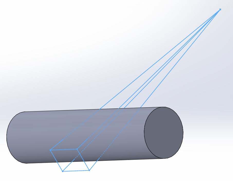

Suppose I have a solid, and I want to use a 3D sketch to make extruded cuts through that solid. Suppose also that the 3D sketch tapers to a point. How can I use the 3D sketch to get Solidworks to make an extruded cut through the solid that is bounded by the 3D sketch? In the picture below, the area bounded by the cylinder and the dotted lines is what I want to remove.
Using Extruded Cut with Taper is not an option since I need to repeat this for a variety of angles and taper distances and I have no desire to calculate the specific angle for each cut. I feel like Solidworks has all the information it needs to do this, I just need to find the correct command to get it to do what I want.
The file has been attached for your consideration. Thanks in advance!

GS 2021-04-08 Best Answer
Like this.

That would certainly work, however, as I mentioned in my initial post, I have a great many of these cuts to do, and all at different angles, so calculating the individual draft angles for each cut would be prohibitively time consuming.

How about a simple extruded cut and apply a draft feature - Like this:

I think I figured it out.
In the interests of being efficient and expedient, I had kept most of my geometry in one 3D sketch. For this second attempt, I made two separate sketches. One sketch for some planes for slicing the solid with and another sketch with the geometry for the boundary cuts.
The Boundary Cut now functions as shown in your video, so I can only assume Solidworks was grabbing the endpoint of a line, rather than a 3D point, and getting confused.

No, I'm able to select the loop as in your video, as well as the point, but Solidworks doesn't add the point to the list of features like in your video. I feel like maybe I'm selecting an endpoint of a line instead of the point, so I'm redoing the project with the aim of creating separate 3D sketches for different purposes instead of using one for everything.

One thought.. Are you using the Selection Manager to select the point?
There's no need to

That's weird, cause that's exactly what I'm doing. I'm using Solidworks 2019. My cursor even changes to the "point" selection, but the little selection box appears and won't let me green check mark the point selection.

Actually went into the help manual to check up on lofts because I just assumed that it would die immediately without a few extra sketches (I don't use loft particularly often either). You can do it using the original single sketch and nothing else.
Use the SelectionManager to form a closed group (the square). Accept that. Then choose the whole 3Dsketch as the 2nd profile. Works like a charm.

Salted Fish wrote:
This does seem like the most direct and expedient fashion. But when I try it on the project that I'm actually working on (in case it wasn't clear, the attached file above was just a simplified demo), I can't select the tip point like I can in the halp file. Thoughts?
I'm not sure sorry.
Here's what I did.
What version are you using?  I have a vague recollection in the past you could only do this with a loft.  But it could of been me being a novice back then.
comment imagecomment image

Gotcha. So you essentially "split" the original sketch into two, separate sketches, and then used those two for the Lofted Cut. That makes sense.

Rob and Glenns solutions are much more efficient.
However, for interests sake: Right click -> Contour select.
Do that a couple of times so that you have Planar Surface 1, then 2. Then hide the sketch and use the Planar Surface tool again but select the edges of Planar Surfaces 1 and 2, to create Planar Surfaces 3 then 4..

I tried using the Loft Cut but was unable to get it to work. Looking at what you did, it appears you used the 3D sketch already in the file, but also made a second one around the "base" of the "pyramid." Is this the case? When I try to replicate the cut with the original file, clicking on the 3D sketch selects the whole "pyramid" and Solidworks complains that it doesn't have enough information when I click the green checkmark.
Steven McCallion
I actually created two new 3d sketches, not one.  The first one used the "Convert Entities" sketch tool to re-create the rectangle from your sketch, and the second one used the same technique to recreate the point on the end.  So the feature doesn't directly use your sketch, but the two sketches used for the feature are driven by your sketch.  I did this because you can't use a single sketch to drive a Lofted Cut (as far as I know; I don't use them often).  That's why you got the error message when you tried to use your sketch.
Make sense?

How did you make the planar surfaces? When I use "Planar Surface," Solidworks doesn't seem to recognize the segments in the 3D sketch as valid components.

I would say the most direct method is a Boundary Cut

This should get you going:
