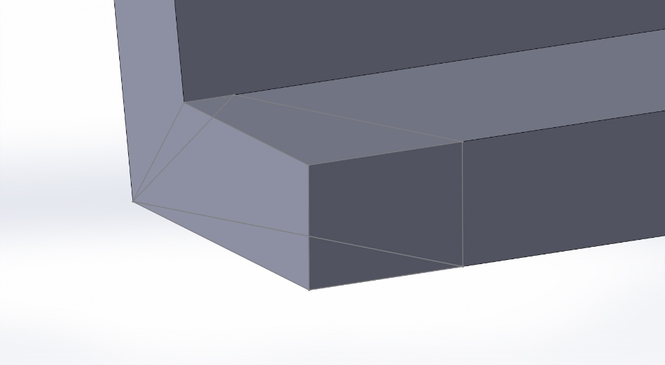

Shown i have a part i created a 3D sketch in that part of an area that i want removed. is there an easy way to have solidwork remove this area in a cut? possibly select all 11 lines in the 3d sketch and remove the surfaces within?

See attached.

thank you I have never used surface fill. deffinitly a very usseful tool to know.

Can be done without fill surface. see below attached component.
