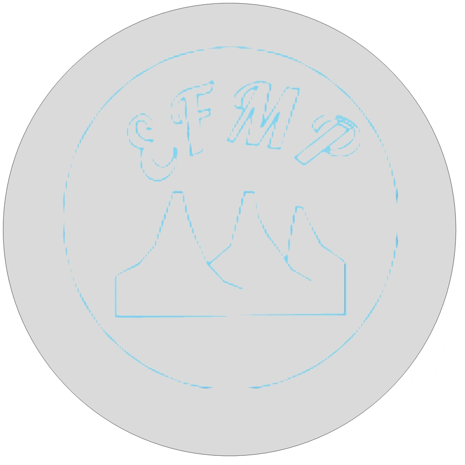

I'm attempting to place this logo onto a model.
Icon is "Picture to sketch".
"some items are too small to convert"
How do I correct for this?
This the dpi to small for this image?
Henry
Henry
Using your image, I inserted into a sketch as a Sketch Picture (Tools>Sketch Tools>Sketch Picture) and I didn't get any warnings or errors.
You can the add sketch entities, mostly splines for your image, the lay over the image's lines.
Optionally, go to Add-ins and enable the Autotrace add-in as this will allow to try to let SW figure out the sketch entities required. This will add an additional page to the Sketch Picture property manager that contains the Autotrace options and settings.
There have always been to options for me. Attempt the sketch to picture and when that fails or if it fails use the picture as a reference to trace the lines. Create multiple sketches when tracing, to keep from making them to large, and making it easier to finding problems when you may have failed to close the sketch.
Clip art is the best for using this tool. Photos from a phone or other device, are not the best to use for translating to a sketch. with the tool.
