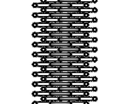

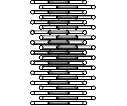

I upgraded to 2020 SP3.0 from 2019 SP5.0 yesterday, and now my drawings look horrible. Is there any setting that may have triggered during the install? I have toggled anti-aliasing and tried draft and high quality image and this is the best I can get when I save to PDF:
2020:
2019 (How it should look):
I can't send this to a customer......

RL 2021-04-08 Best Answer
I exported the PDF @ 600 dpi and got this:
Better, but still pretty rough

That features should still be considered beta, IMO.
RL
RL 2021-04-08
SUCCESS!!!!!!!!
I would have never thought turning this OFF would improve graphics. Thanks for the help everyone!

Not to be fatuous, but did you check your PDF export settings to make sure you have high-quality lines enabled (renders them as vectors instead of raster)
-and another thing, the view will only render as raster if it's set to display with Draft quality:
have a look at those settings and let us know how it goes.

I can't imagine how it would affect an exported PDF, but I would try toggling the state of the "Enhanced Graphics Performance."

Here is what I find very strange... turning tangent edges ON seems to help.
Tangent Edges OFF:
Tangent Edges ON:
...so for now this is my workaround. It has to be graphics related.
