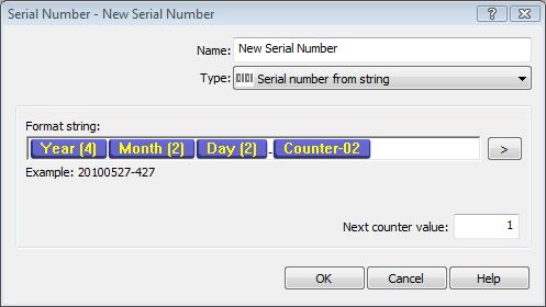

Here Is the format I'm looking for:
...but I want to reset the two digit portion every day.  I'm not even seeing a way to do this via the api.
Am I missing something?

If the Serial Number generator was used 5 times in one day, then the "Next counter value" would be 6.
Reset using the API, can't help you there

I'm aware that you can reset the counter in that dialog...I want to reset it on a schedule (every day).  I don't see anything exposing that in the api.

I can code myself...I just don't see anyway to interact with the s/n generators via api.  I was wondering if I missed something.

Yeah, I don't see any either. You may have to go directly to the counter's db table and reset it with SQL.

That's what I was thinking...I hate to step outside of the api unless I have to.
Another alt that I've found is in the API help file (example):
Creating Serial Numbers Using Visual Basic
<p>Public Sub GetAddInInfo(ByRef poInfo As EdmLib.EdmAddInInfo, ByVal poVault As EdmLib.IEdmVault5, ByVal poCmdMgr As EdmLib.IEdmCmdMgr5) Implements EdmLib.IEdmAddIn5.GetAddInInfo</p><p></p><p>  'Return information about this add-in to PDMWE in the struct<br>  poInfo.mbsAddInName = "My serial number generator"<br>  poInfo.mbsCompany = "The name of my company"<br>  poInfo.mbsDescription = "Implements serial numbers."<br>  poInfo.mlAddInVersion = 1<br>  poInfo.mlRequiredVersionMajor = 5<br>  poInfo.mlRequiredVersionMinor = 2</p><p></p><p>  'Tell SolidWorks Enterprise PDM that we can generate serial numbers.<br>  poCmdMgr.AddHook(EdmCmdType.EdmCmd_SerialNo)</p><p></p><p>End Sub</p><p></p><p>Public Sub OnCmd(ByRef poCmd As EdmLib.EdmCmd, ByRef ppoData As System.Array) Implements EdmLib.IEdmAddIn5.OnCmd<br><br>  'Check the upper and lower bounds of the array. <br>  Dim index As Long index = LBound(ppoData) <br>  Dim last As Long last = UBound(ppoData) <br><br>  If index <= last Then <br>    Dim cnt As Integer <br>    cnt = last - index + 1 <br><br>    'Create a temporary array we have full access to <br>    Dim tmpArr(cnt) As EdmCmdData <br>    tmpArr = ppoData <br><br>    'Generate serial numbers for all of the affected files. <br>    Dim CounterVal As String <br><br>    While index <= last <br>      CounterVal = tmpArr(index).mlLongData1 <br>      Dim s As String <br>      s = "My serno(" + CounterVal + ")" <br>      tmpArr(index).mbsStrData1 = s <br>      index = index + 1 <br>    End While <br><br>    'Return the updated data <br>    ppoData = tmpArr <br>  End If <br><br>End Sub</p>
Obviously, you can get that format within the normal generator but it shows you can color outside of the box if you desire.
