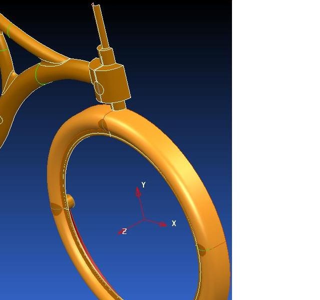

dear sir,
i have any problem about difference of extrude(like my attachfile), how to make it's simple????i try to make a sketch first andthan extrude with different high that sketch but i doesn't work
can you help me how to fix that????
best regard,
