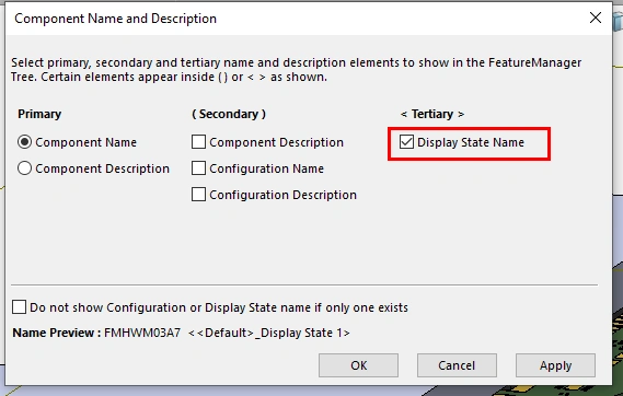

I found the function "SetComponentIdentifiers" but I think there is an issue with the Tertiary setting.
I can check the box but i cannot UNCHECK the Box.
The definition is:
          value = instance.SetComponentIdentifiers(Primary, Secondary, Tertiary)
In my code, this will check the Tertiary Box:
          compIdentifierRet = swFeatMgr.SetComponentIdentifiers(2, 0, 128)
But This will NOT uncheck the Tertiary box
          compIdentifierRet = swFeatMgr.SetComponentIdentifiers(2, 0, 0)

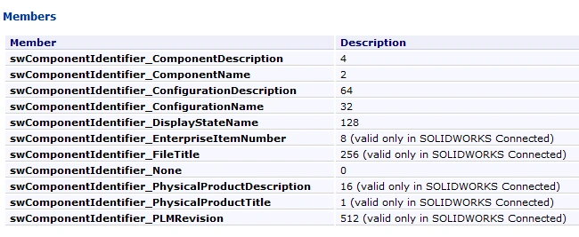

The component identifiers are:
