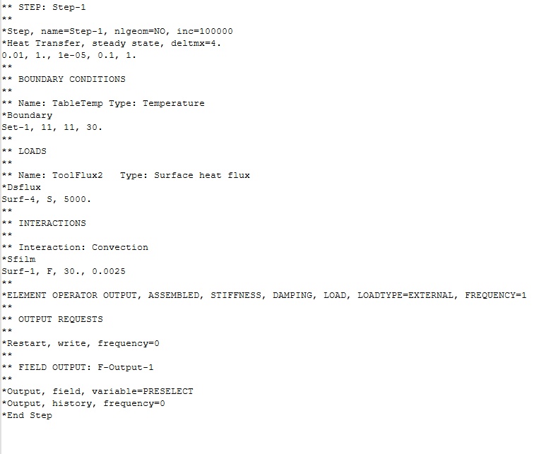

i'm trying to export the thermal matrices from an steady-state heat transfer simulation using the *ELEMENT OPERATOR OUTPUT keyword following the steps in the documentation. The code is shown in the figure.
I start the simulation via the command window using the command: abaqus job=BlockHeatTestV2 resultsformat=sim interactive
When I run the simulation, it always throws the same error, no matter what changes I make. The error message is as follows:
 ---------- RUNTIME EXCEPTION HAS OCCURRED ----------
*** ERROR: ABAQUS/standard rank 0 encountered a SEGMENTATION FAULT
If I omit the lines for the export, the simulation runs without problems and delivers plausible results.
Do any of you have an idea how to solve this problem?
