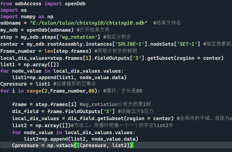

I tried to get S11 using python, but couldn't. However, I was able to get the displacment using the same method.
Here's the script:
from odbAccess import openOdb
import os
import numpy as np
odbname = "E:/tulun/tulun/chixing10/chixing10.odb"
my_odb = openOdb(odbname)
step = my_odb.steps['wg_rotation']
center = my_odb.rootAssembly.instances['SPLINE-1'].nodeSets['SET-1']
Frame_number = len(step.frames)
local_dis_values=step.frames[1].fieldOutputs['S'].getSubset(region = center)
list1 = np.array([])
for node_value in local_dis_values.values:
list1=np.append(list1, node_value.data)
Cpressure = list1
for i in range(2,Frame_number,80):
frame = step.frames[i]
dis_field = frame.fieldOutputs['S']
local_dis_values = dis_field.getSubset(region = center)
list2 = np.array([])
list2=np.append(list2, node_value.data)
Cpressure = np.vstack([Cpressure, list2])
The printed outcomes are:

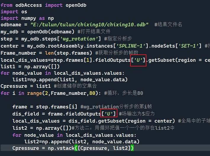

But if I change the outcome into U, the method works somehow.
I wonder why
