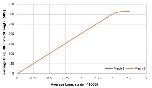

What is the criteria used to end a nonlinear Riks step in Abaqus?
Considering a plate model under tensile loading, when analysed nonlinearly using Riks step, how is the run decided by Abaqus to end. Attached the stress-strain curve obtained from the mentioned model with an ultimate capacity of 313.3 MPa.
I thought that I will need to input a condition that when reached, Abaqus is to end the run. Because under tensile I expected the model to keep deforming.
The material model used is elastic-plastic with a strain hardening of 1000 MPa, a yield strength of 315 MPa and ultimate tensile strength of 440 MPa. ​​​​​​​

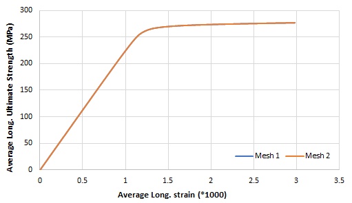

For other load-cases, e.g. combined biaxial tensile ​​​​​​​and lateral pressure, the stress-strain curve is:
