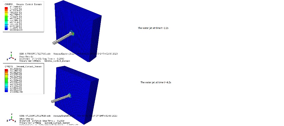

My issue is that, although the C-PRESS data indicates that the water jet successfully contacted the plate and spread on the surface of the plate, the models shown in the ODB data only display the water jet, the water spread on the surface cannot be found (similar to what Picture 1 shows). Is this normal for this type of simulation, and if I want it to display the water on the plate, what adjustments should I make in the settings?

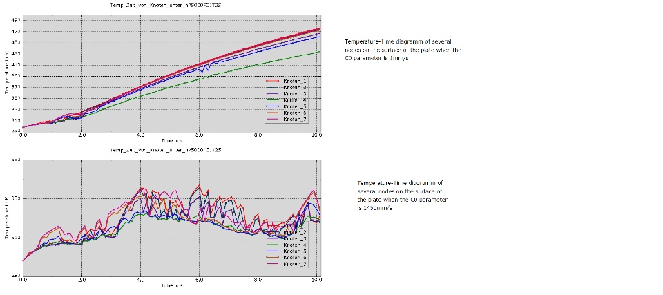

Another question is that I've seen in the literature that, in order to simulate the physical change of water, one needs to set the property → Equation of State → Us-Up. The recommended setting I received is C0 at 1450000 mm/s, and the other two parameters, 's' and 'Gamma0', are both set to 0. I experimented with giving C0 a much smaller value, such as 1 mm/s or 1450 mm/s, which significantly reduced the time required for the simulation. However, it also caused considerable variation in the results of the heat transfer analysis (as shown in Picture 2). I would really like to know how this setting (EoS-Us-Up) affects the analysis of temperature results and why it also changes the simulation speed. I would greatly appreciate it if you could answer my questions.
