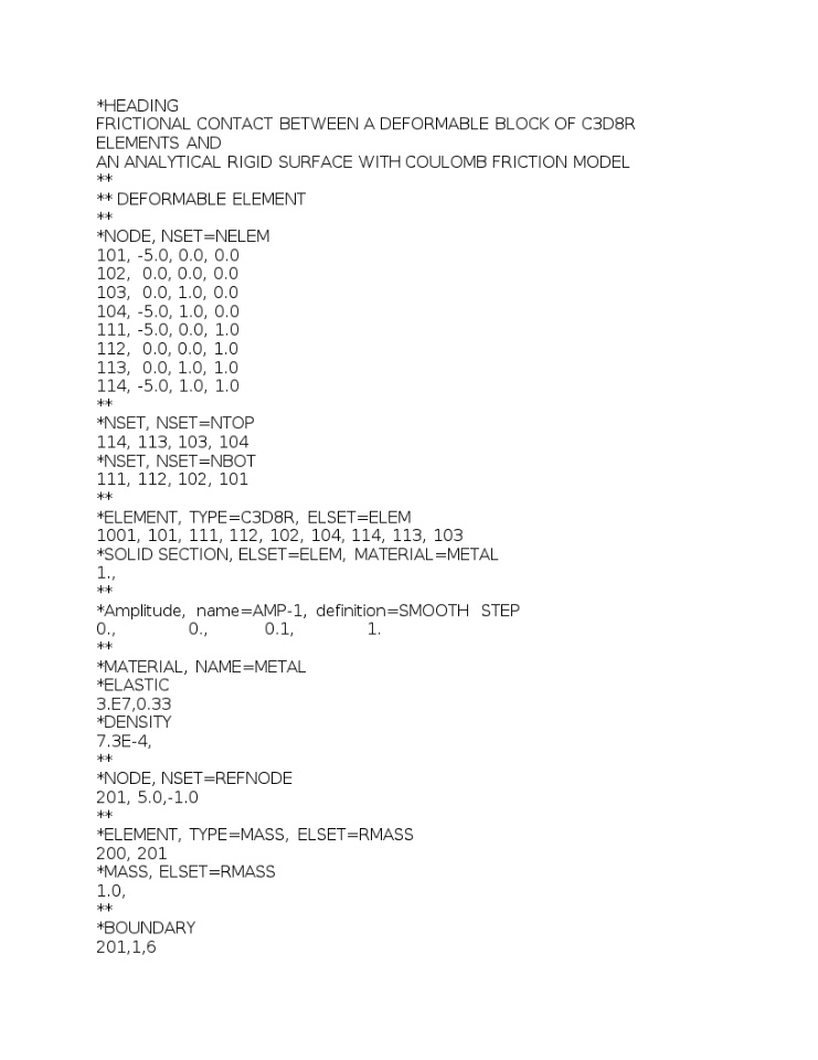

Example | Attached are two example .inp files (vfriction_coul_inp and vfric_coef_coul_inp) that replicate the erroneous behavior with a SMOOTH displacement amplitude applied to a simple block and constant friction coefficient (μ=0.15). These may be run with vfriction_coul.f and vfric_coef_coul.f from “4.1.30 VFRIC, VFRIC_COEF, and VFRICTION” of the Abaqus Verification Guide.
