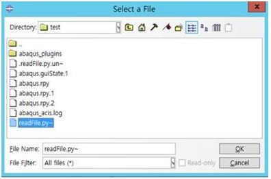

I am trying to implement the following operation in Abaqus GUI toolkit, but I cannot figure the procedure.
In a simple GUI as shown below (from the left to the right, txt file, File slection DB and GUI DB),
1. In File Selection DB, after selecting the *.txt file, press the OK button,
2. Pass the selected file name to the kernel.
3. Perform some algebraic operations in the kernel (e.g. 2+3=5)
4. Print out the input values (2, 3) and output value (5) in the GUI DB
Actually, I have no idea how to implement step 4. That is, how can I print out the passed values in the main DB from kernel?
