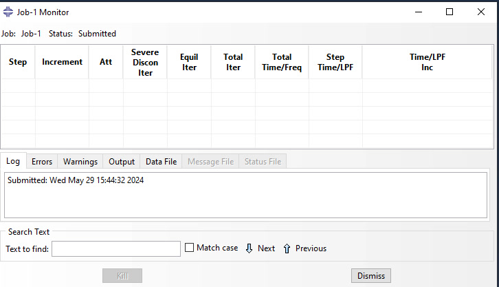

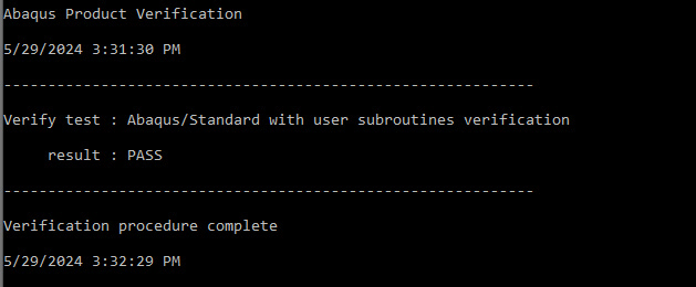

Hi,
I am trying to run some models with user subroutines. I have linked the Fortran compiler, and the user subroutine verification shows "Pass". Also, abaqus info shows the compiler is linked. The user subroutines run from the Abaqus command (Abaqusjob= user= interactive) .However, when submitted from the Abaqus CAE, it does not run. The job status in CAE says submitted, but the job is not submitted and does not use any licenses. There are enough tokens and licenses as well. I have linked the "vars.bat" for the Abaqus CAE shortcut as well( "C:\\Program Files (x86)\\Intel\\oneAPI\\compiler\\2024.1\\env\\vars.bat" -arch intel64 vs2022 & abq2023 cae). I have abaqus installed in two machines and in both of them user subroutines do not run when submitted from CAE. Other jobs without user subroutines run properly. Any idea what the issue is? Thanks.
