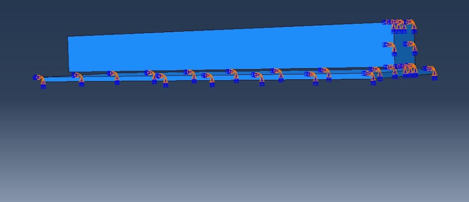

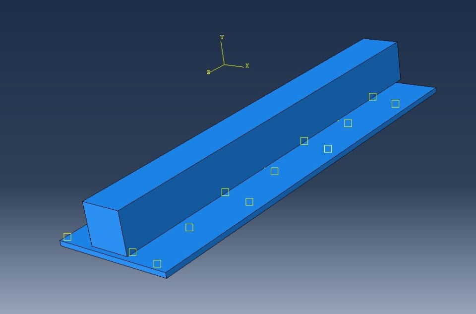

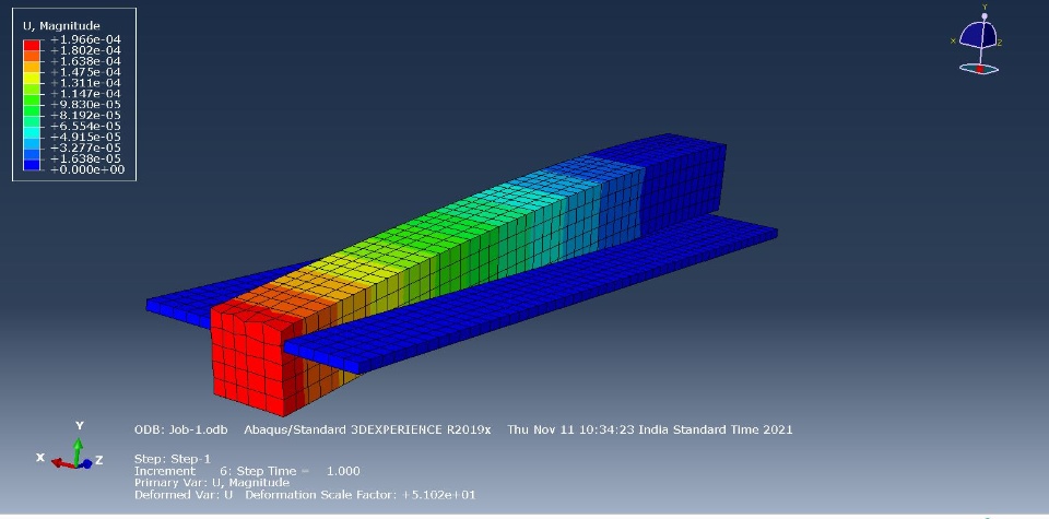

A load has been applied on the end of a cantilever beam below which a fixed plate is placed such that deflection of the beam is more than the distance between fixed plate and beam also I have specified interaction as a surface to surface contact with frictionless contact property and hard contact. but during running, it shows warning signs that there are “two unconnected regions”. after the completion of the simulation I am not getting desired results please help. I am attaching the images.
