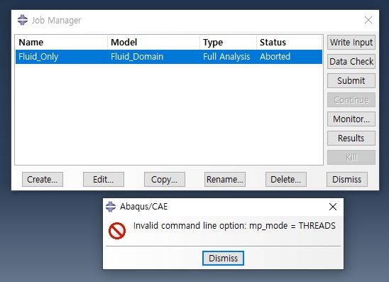

Unable to start a job, ABAQUS6.14 CFD
Running CFD job in Abaqus6.14
I cannot even start a job. It shows me "Invalid command line option: mp_mode = THREADS

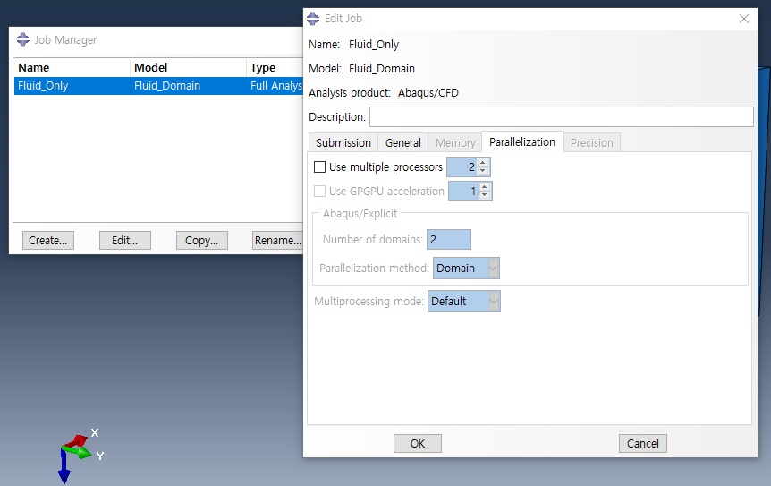

I tried to change the job option to MPI but it doesn't allow me to do that.
How can I resolve this error?
