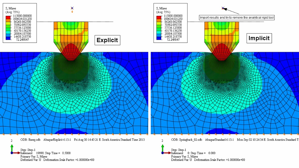

Have anyone ever used the Abaqus feature "Initial State" to transfer results between Abaqus Analyses?
I'm trying to transfer an initial state from an Abaqus/Explicit analysis and continue the analysis in Abaqus/Standard.
You can see in the attached image, I need to make the first analysis (picture on the left) using Abaqus/Explicit to use the ALE adaptive meshing technique, and I want to remove the tool, to see the "springback" using Abaqus/Standard to improve computational cost...

I think the problem is not in transferring results, as you can see the initial state on the initial time of the implicit analysis is the same of the end state of the end time of Explicit analysis...
