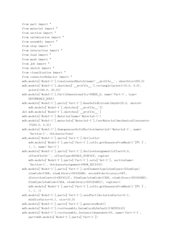

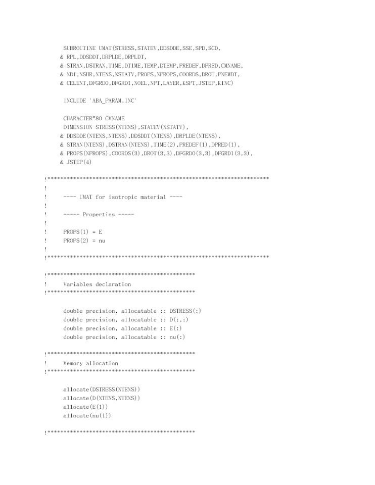

I discovered a bug in Abaqus 2017.HF9. Abaqus solver ignores auto time incrementalization constriants in the case of using UMAT user subroutine where PNEWDT = 2 is specified. Increment size can grow unlimitedly despite specified constraints. A script for creation of model and user subroutine file can be found in the attachment.
Steps to reproduce the bug:
1. Rename Model_for_bug_demonstration.txt to Model_for_bug_demonstration.py (sorry, it's not possible to attach *.py file here).
2. Rename umat_isotropic.txt to umat_isotropic.for (sorry, it's not possible to attach *.for file here).
3. Run the python script Model_for_bug_demonstration.py to create the model.
4. Run Job-1 with the user subroutine umat_isotropic.for.

Input file contains the following parameters:
*Step, name=Step-1, nlgeom=NO, inc=10000
*Static
10., 200., 0.001, 10.
UMAT contains the record:
PNEWDT = 2
