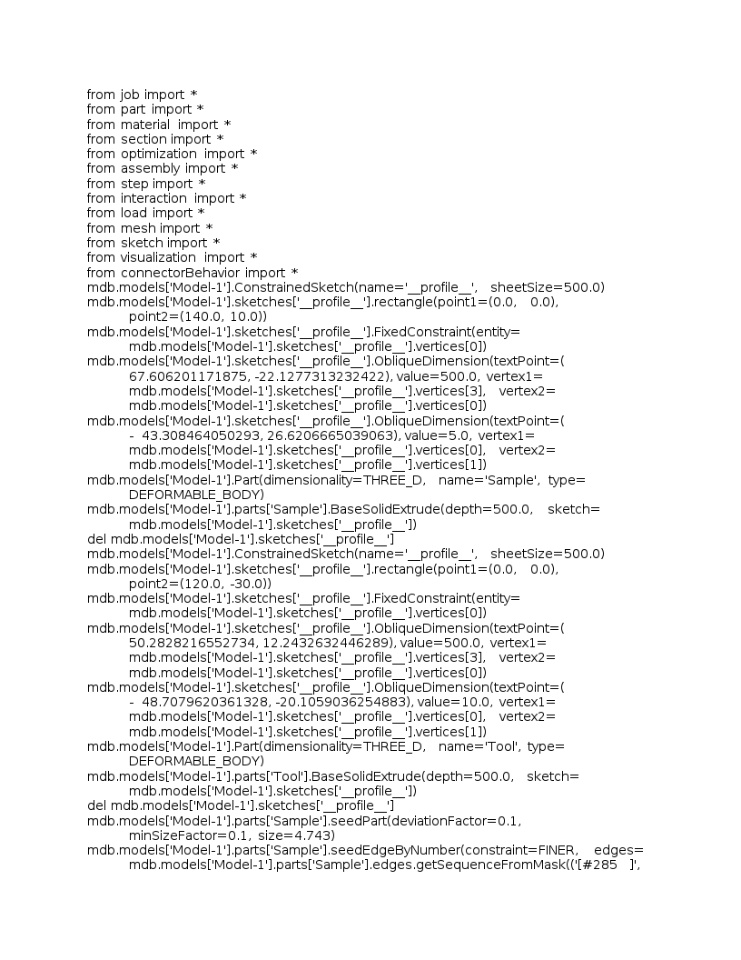

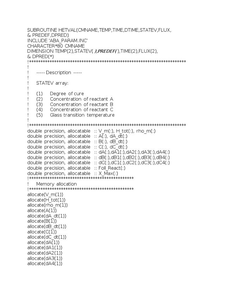

I created two models that are very close to real simulations. These models differ in total number of elements. One of them is “light” and counts about 40 000 elements, and the other is “heavy” with about 900 000 elements total. Both models simulate curing of a composite and must be run with a user subroutine file. To recreate the models, use files in the attachment:
1. Change file extensions of model_light.txt and model_heavy.txt to *.py.
2. Change file extension of user_subroutine.txt to *.for.
3. Run python script model_light.py or model_heavy.py to create desired model.
4. Locate user subroutine file user_subroutine.for in job properties.

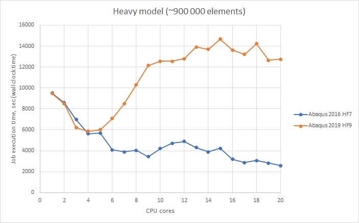

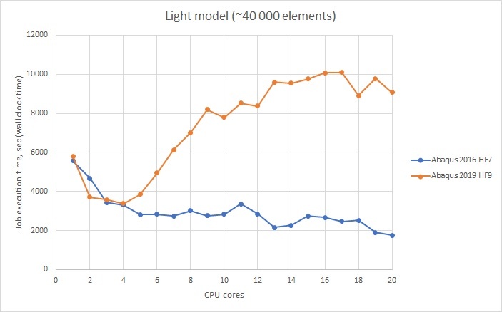

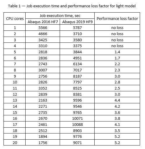

The loss of Abaqus 2017-2019 performance comparing to Abaqus 2016 relates to running jobs on multiple CPU cores. Hereinafter, job execution time is measured in terms of wallclock time which can be found in the .msg file. Results of testing both models on 1–20 CPU cores are given below.
Something strange happens with Abaqus 2019 on both models when running jobs on 6 or more CPU cores. As the number of CPU cores increases, we can see the growth of performance loss factor from 1.5 to 5.
I think I probably captured a bug. If it is so, I would be very grateful for resolving this in some fix pack for the 2019 release of Abaqus.
