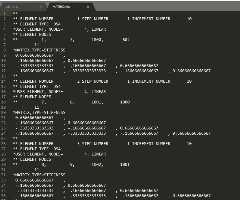

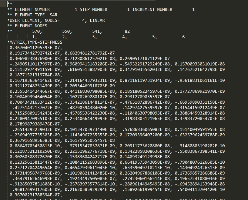

For either general displacement element or heat transfer element, I can export the elemental stiffness matrix by having an extra line in the keywords window:
*File Format,Ascii
*Element Matrix Output,Elset=All,File Name=MATRIX,Frequency=50,Output File=User Defined,Stiffness=Yes
