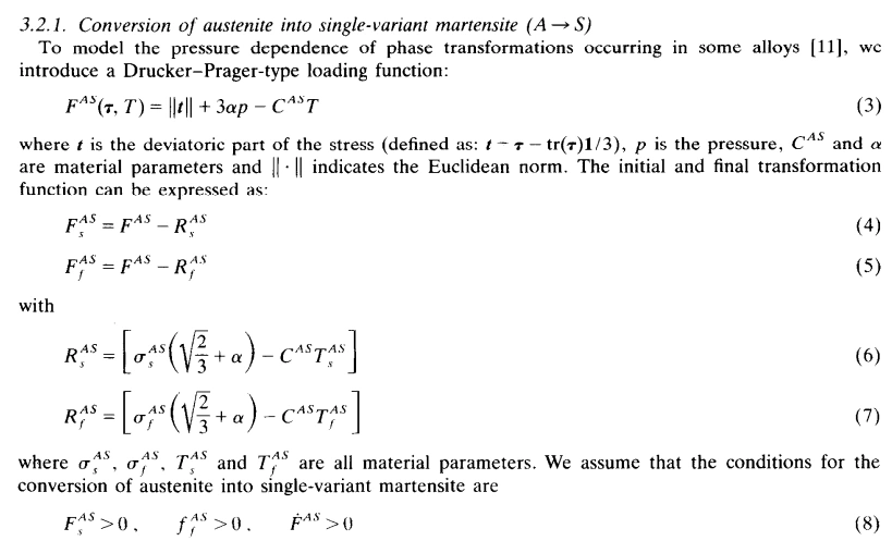

What is the relationship between the Reference Temperature T0 in Superelastic materials in Abaqus and the TASs, TASf, etc. in the reference literature? Are the meanings of and in Abaqus the same as those of and in the reference. Thanks.
