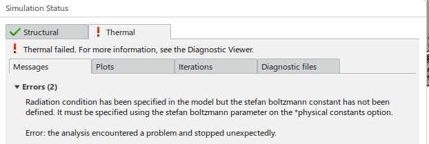

Hello Simulia community,
I am creating a thermal model in 3DX Mechanical scenario and I need to include a radiation to ambient boundary condition. Solution fails because Stefan-Boltzmann constant is missing, but I did not find where to assign it.
Do I need to specify it by Keyword Edit?
