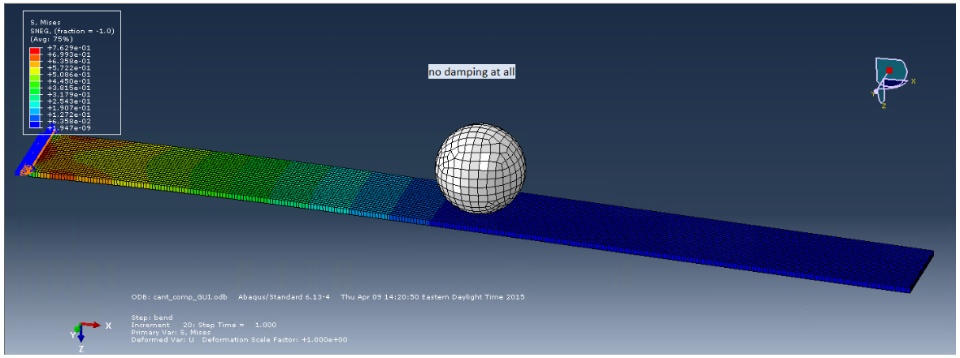

I was getting very problematic results, so I built a simple model comparable to the first step of the complex model. A shell-element cantilever beam is displaced by a contact interaction with a sphere.
With no damping the results are as expected and displacements and maximum stresses agree well with analytical beam bending formulas, suspect the the small (e.g. <2% for tip displacement) differences are because of the contact-loaded wide, thin beam I'm using.

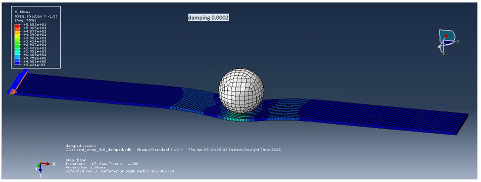

with a damping factor 0.0002 (the original other model had 20! ) the result is a nonsensical localized deformation:
a damping factor of 2e-7 expands the area of sphere influence but still gives significant error.
