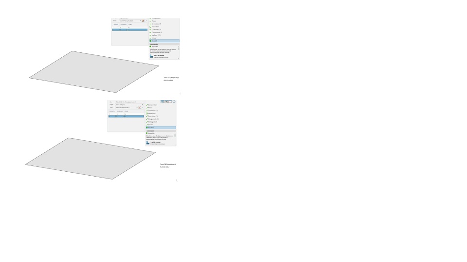

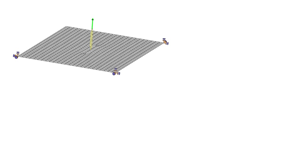

Trying to understand how to get force in a spring connector, i did a very basic analysis (see pic below : a 1000N force applied on a spring, spring connected to a fixed plate).
The analysis is OK.
The output visualisation is not, i really dont understand why (visualisation group are OK).
Neither contour force in connector neither contour elastic force gives a force value (see pics below, sorry for the french and CTF/CEF names)

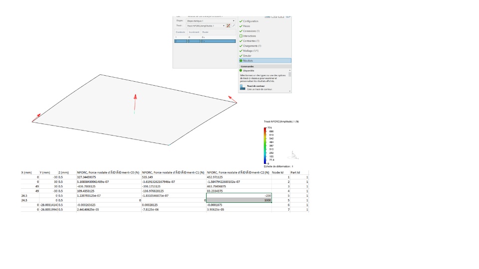

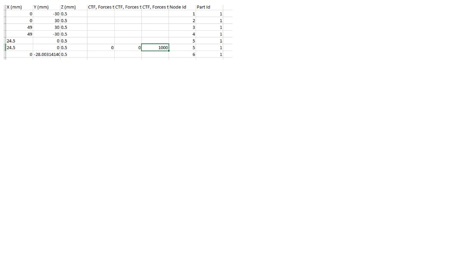

When I export the element force result table i actually see the force at node 5 (see pic below).
When i export the NFORC table i actually see 2 contributions at node 5 (spring + Quads). In my very simple case it's easy to know which line is the spring contribution, which line is the shell elements contribution. In a more complex model how could i know which line is for which contribution ?
I'm reading it looks possible with Abaqus interface to output s11 to read the spring force, i cant manage to do it using Simulia ...
Can I only see a connector force results at nodes and not at element ?
