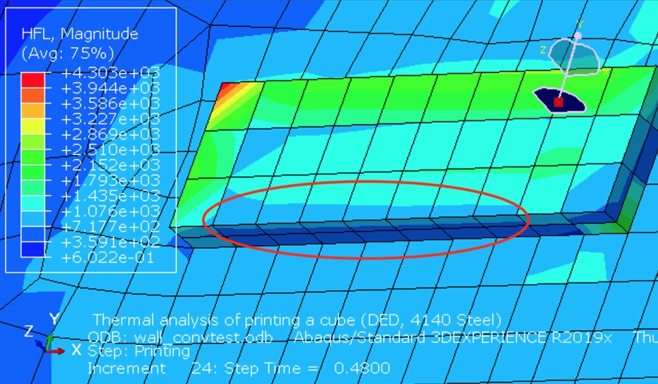

I am applying a concentrated film on my newly activated elements from UepActivationVol. However, I noticed some nodes are not being called in my FILM subroutine even though they are active in the model. I have tested other nodes which are active and have received outputs by using if (node.eq.nodenum) then...The nodes on the new layer (circled in red) are not being called and it shows in the model since the user defined film coefficient is not being applied.
