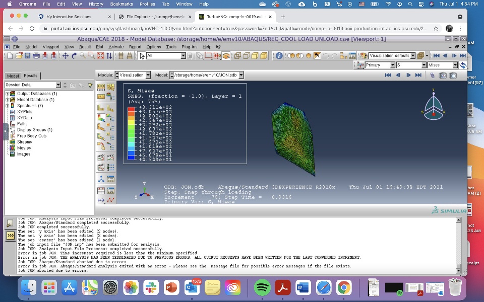

Hi all,
I am having issues with the convergence of a model. The error reads: time increment is less than minimum specified. This is what I tried so far:
Refining the mesh.
increasing IA(increment attempt)-steps module-other-General Solution Controls-Edit-Step-1-continue--specify-Time Incrementation-more-IA=30
Any ideas of what else I can try?
Thanks!!
