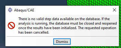

Sequential element activation for additive manufacturing. Simulation is running smoothly with no issue but no odb database is created.

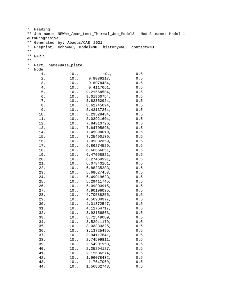

I have been trying to model laser powder bed fusion process using progressive element activation. In the given input file the "*ELEMENT PROGRESSIVE ACTIVATION" for the element sets corresponding to layer 2 & 3 just before "* End part" keyword under part definition of both the layers.
Further I have been using UEPACTIVATIONVOL subroutine to activate the element set corresponding to these layers using "* ACTIAVTE ELEMENT" under addlayer2 & addlayer3 steps of the model.

What I found that the simulation was running smoothly (as it was running before, without UEPACTIVATIONVOL using only DFLUX) with some warning messages:
***WARNING: FOR *TIE PAIR (ASSEMBLY_LAYER1_BOTTOM-ASSEMBLY_BASE_TOP_SURFACE),
            ADJUSTED NODES WITH VERY SMALL ADJUSTMENTS WERE NOT PRINTED.
            SPECIFY *PREPRINT,MODEL=YES FOR COMPLETE PRINTOUT.
 *tie, name="ASSEMBLY_layer1 and layer2", type=SURFACETOSURFACE, adjust=YES
***WARNING: FOR *TIE PAIR (ASSEMBLY_LAYER2_BOTTOM-ASSEMBLY_LAYER1_TOP),
 *tie, name="ASSEMBLY_layer2 and layer3", type=SURFACETOSURFACE, adjust=YES
***WARNING: FOR *TIE PAIR (ASSEMBLY_LAYER3_BOTTOM-ASSEMBLY_LAYER2_TOP),
But these running analysis is not producing any odb file output.
For reference I am also including the .sta file for the analysis:--
Please let me know what is the issue going on
