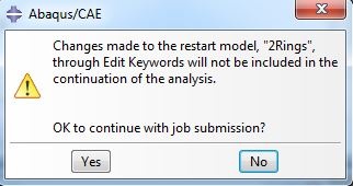

When I run the model through the "restart" job file I get a message that the model has been changed through keyword editor and any changes will not be included in the calculation.
