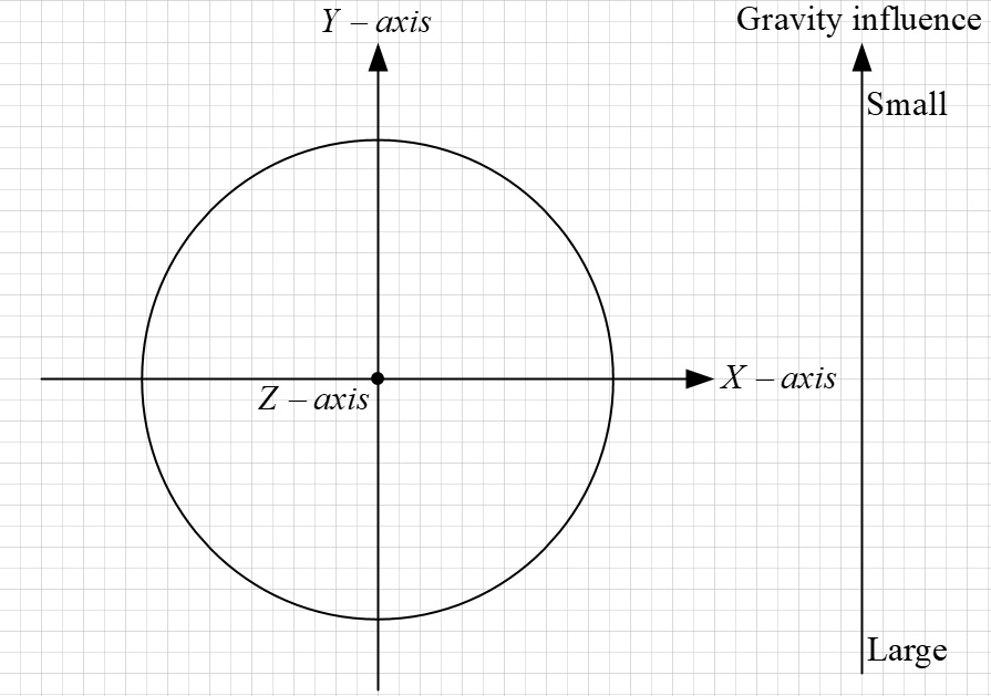

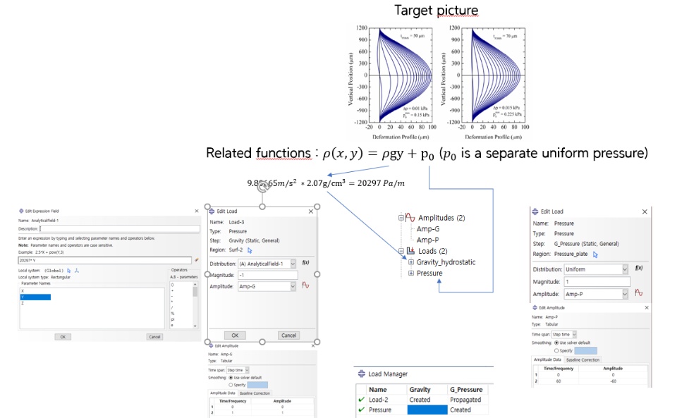

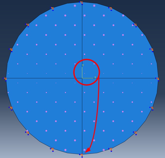

Hello, I have a problem with pressure input in abaqus, so I have a question.
In the circle plate, I am going to give the pressure change by height using the following equation.
fluid density * gravitational acceleration *Y (y-axis)
I approached the direction of using the integral, but I am wondering what to do because there is no integral among the 'operations and functions' in 'distribution'.
It would be nice if you could explain it in detail.
