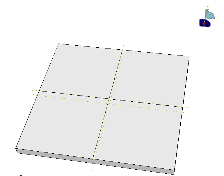

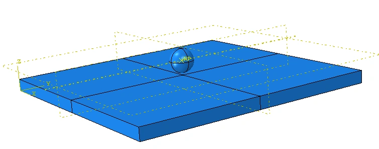

Impact simulation model

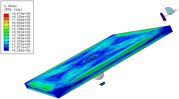

Impact simulation results

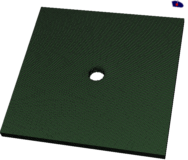

initial state - 1
initial state - result
initial state - 2
