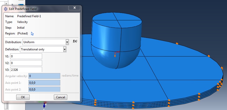

Hello All,
I am trying to simulate an impact problem using Abaqus Explicit (V-6.14). The model consists of a composite plate (modeled with Continuum shell element) and a rigid impactor (fig attached) and general contact (Fig-2). Since I don’t know the velocity amplitude profile; Initial velocity is applied at the reference point of the impactor Using predefined field option (Fig-1). My expectation was that Abaqus would compute the velocity profile (Change in velocity before and after the impact) and accordingly response of the plate to that velocity loading.

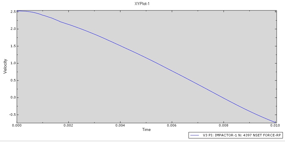

  1. Velocity (v3) at reference point shows a linear variation of the given velocity (initial velocity - zero) over the period of simulation time. (Fig-3)

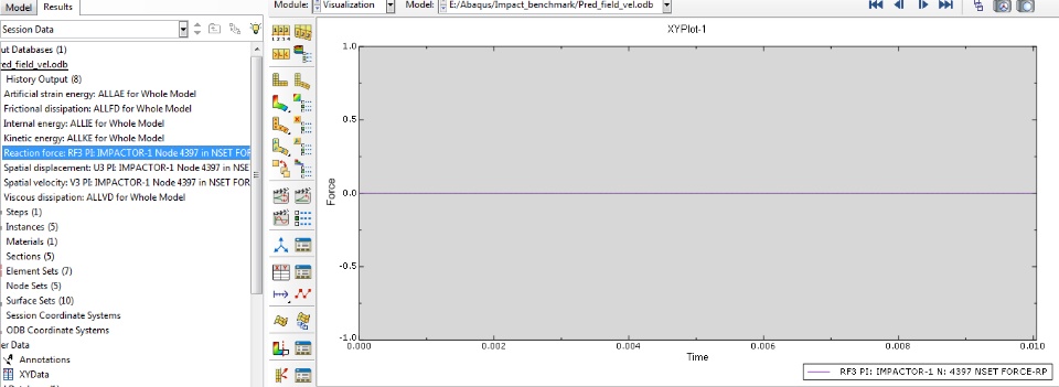

  2. Reaction force (R3) at RP is zero. (Fig-4)
I am new to Abaqus, can anyone please let me know how to resolve the above mentioned issue.
