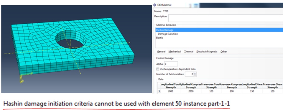

I am using ABAQUS 2017 to analyze composite structures and I would like to ask for your help:
Progressive failure analysis is available to apply to shell elements (Hashin damage), but it seems do not work with solid elements: Hashin damage initiation criterion cannot be used with elements xxx…
I also checked discussed topics related to this and find out that Abaqus only support shell elements and to use solid elements, people need to build their own UMAT for composite failure. Am I right?
Please check the attached figure.
