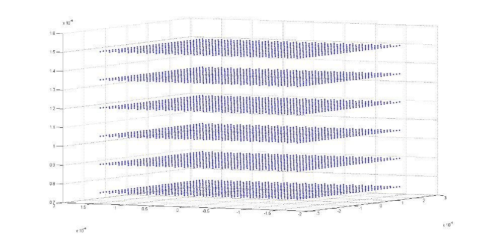

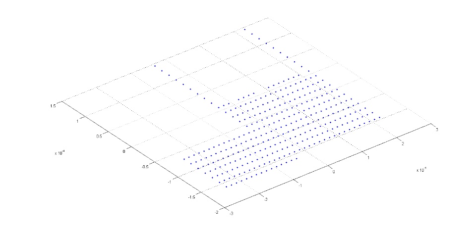

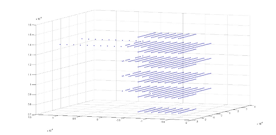

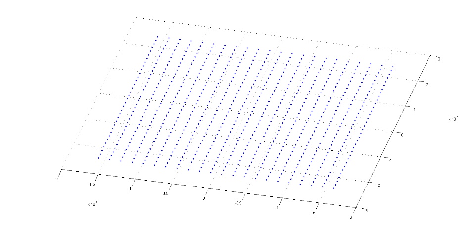

These are the results I get from Abaqus 6.13:
This is from Abaqus 6.12:
