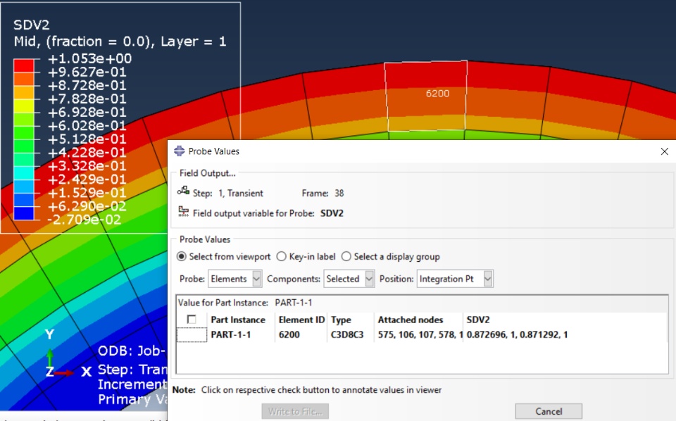

Is it possible to plot integration point values instead of the "standard" extrapolated nodal values?
I found the query "probe values" but it was easier to visually see these values.
See the picture attached: the maximum integration point value is 1 but the nodal values are higher, up to 1.053. I´d like to see the integration point values.
