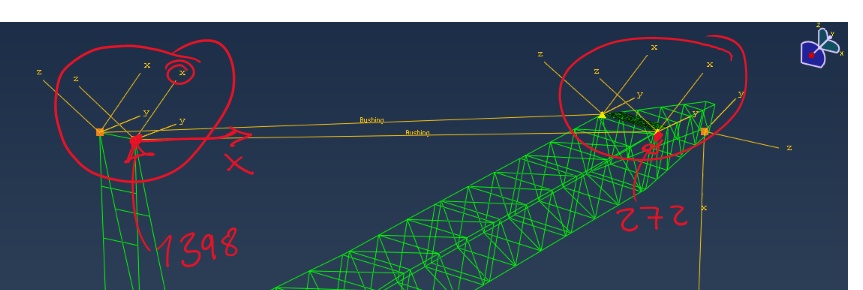

*ORIENTATION, DEFINITION=NODES
Hi, i am struggling with using the *ORIENTATION keyword alongside the definition=NODES. I am trying to model a bushing connector with a CSYS' x-axis following 2 specificed nodes. My initial attempt (shown below) was unsuccessful The history output and the visualization in ODB (included image) shows that the x-axis of my orientation is off. Any ideas?
*Orientation, name=luffing_csys_2,
SYSTEM=RECTANGULAR,
DEFINITION=NODES
CRANE_BASE_CASE-1.1398, CRANE_BASE_CASE-1.272
