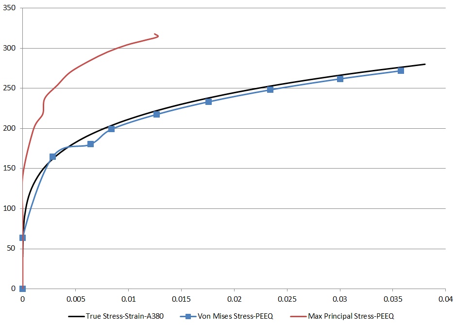

I was trying to run a  model with non linear cast aluminum material properties.
I usually report Maximum Principal Stress when using linear material.
But when using non-linear material i am getting very high values of stress, even crossing ultimate stress which is very surprising.
When i checked the values for Von Mises stress, it is coming well within the material curve that i defined, but i cant report it because it hold good only for ductile materials.
I want to know why this difference is coming and also in such scenarios what stresses needs to be reported.
I have also attached a pic showing how the Max Principal Stress and Von Mises Stress compares with the True Stress Strain Data for Aluminum.
I want to understand the calculations behind it.
