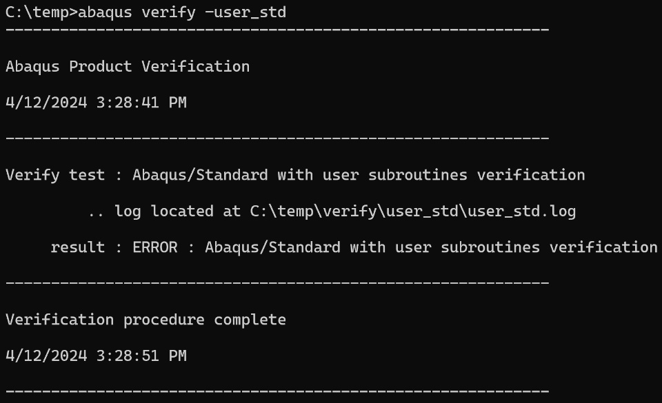

Running
abaqus info=system
shows that the intel fortran compiler is indeed linked properly, but then running
abaqus verify user_std
results in an error, shown in the included screenshot. Investigating the *.log file shows that the analysis fails during the call to standard.exe, but no further details are provided. A similar error occurs for
abaqus verify user_exp
Are there any new special modifications to the installation process for fortran-based user subroutines which are needed for Abaqus 2023 or newer? Many students and myself have spent considerable time trying to fix this issue by modifications to the installation document and consulting colleagues with experience in the area, all to no avail. We can get by with older versions of Abaqus for now, but of course would like to keep up to date with the newer versions of the software.
