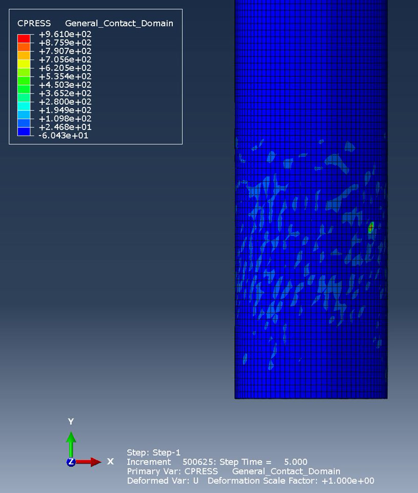

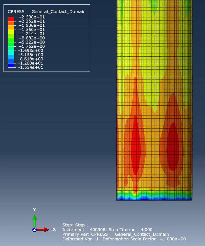

Hi there community,
I'm a postgrad student trying to incorporate cohesive friction interaction to model longitudinal fibre debonding in microscale composite materials. In this case, I'm using the full plastic curve for the matrix, which includes softening with a late small hardening and hexagonal carbon fibre packing. While I'm using Abaqus/explicit in order to model this matrix, the contact interaction has been causing all sorts of problems, generating weird interactions with the pressure, stresses and elements getting snagged. I've tried adding and removing dampening (linear, quadratic, contact, damage) to no great avail.
 In general terms, I'm using displacement control with a smooth step to load the composite to 2% strain. I've included the images of the pressure on the fibre that is debonding. where the hotspots are located in the direction of neighbouring fibres. A second image shows how, in the later stages, the pressure starts localizing into specific nodes. Which leads to the failure of the analysis due to excessive distortion in these elements. Finally, at the end is the matrix material definition, contact interaction and contact behaviour definition.
At this point, I'm open to any and all ideas and would greatly appreciate your unique perspectives on this matter.
Thank you for your time!
PD: I've reposted this as I previously posted it in the wrong section. Sorry.
Latest stable pressure time increment:
Highly localized pressure on some nodes:
Material configuration:

*Contact Inclusions, ALL EXTERIOR
*Contact Property Assignment
,  , empty
Part-3-1.M-surf , Part-4-1.F-surf , coh
*CONTACT CONTROLS ASSIGNMENT, TYPE=SCALE PENALTY
Part-3-1.M-surf , Part-4-1.F-surf , 0.5
*Contact Mass Scaling, Location=SPECIFIED SURFACES
Part-3-1.M-surf, Part-4-1.F-surf
