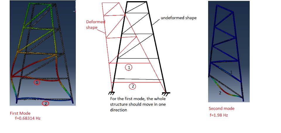

Hello everyone. I am modelling a 2D frame in Abaqus software and finding the structure's mode shape and natural frequency. I attached a photo of my structure. I think the first-mode shape of the structure is incorrect because the whole structure should move in one direction and vibrate in the first mode. I highlighted two members(1 and 2). These members looked like they were vibrating in the second mode even though the mode shape was 1st. I think this analysis is not correct. Can u please guide me on what I should do to get the correct answer...The bottom BC is fixed and doing 2D analysis.
