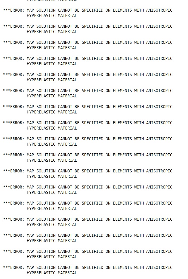

I am trying to do an indentation test and restart the mesh with map solution for HGO anisotropic model. I am able to do the *map solution with the Ogden model. However, it won't work as soon as I switched to the HGO model with almost the same setup and everything. I have looked in to the Abaqus doc and it said"
Material options
Any of the mechanical constitutive models available in Abaqus can be used in a mapped solution analysis (see Part V, “Materials”). There is no restriction on agreement between material models in the old and new analyses. The solution mapping algorithm will transfer those variables common to both models. You must ensure that the material models are compatible." Any help would be appreciated and thank you.
