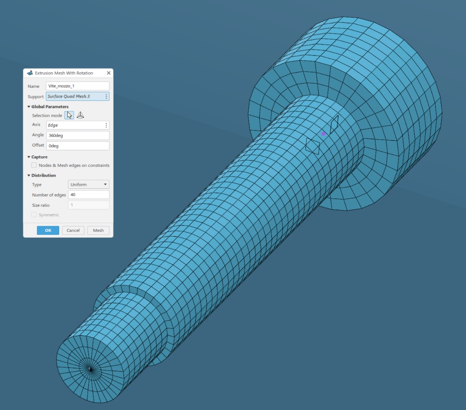

I am trying to mesh a bolt with brick elements in 3dexperience Simulia. To do that, I used a 2d quad mesh and revoluted it with the command "Extrusion mesh with rotation".

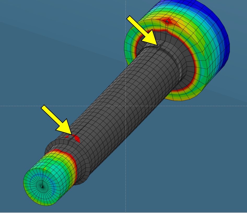

When I checked the result, I noticed that the bolt nodes were not merged.
How can I merge the nodes in order to define a solid brick mesh from a quad elements?​​​​​​​
